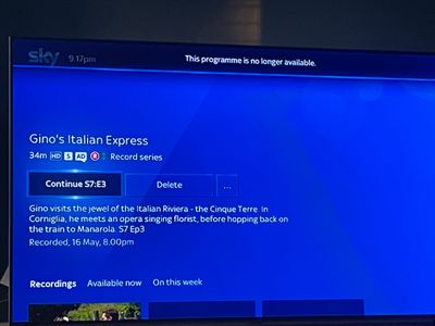

Tried that yesterday as programs were again failing. Worked fine after it and this morning. Just tried to watch a recording now and it's happened again. 🤬

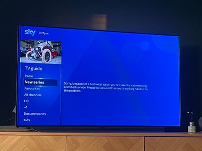

Still having this issue and now I can't get New series!

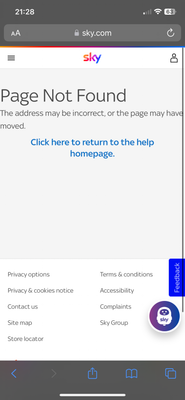

So I tried to send Sky a message with their online form..........the result was this....
