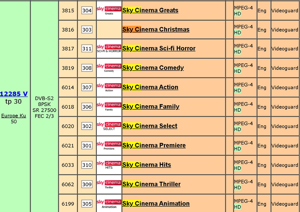

Are there any other channels on that trasnponxer frequency you can test?
The 70/90 thing is on a specific frequency. It's possible others like the one your problem is appearing on are affected by something (usually alignment but can be obstructions) that the test freq is not.

@Blue.Sky 12285 is aEurop wide footprint, and if the dish is slighly misaligned would cause issues.
Is this the only channel affected, have you teied these channels too?

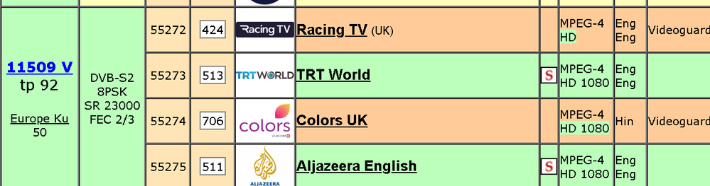

@Blue.Sky Are any of these FTA channels affected also?
Message posted on 21 Nov 2023 01:08 PM
Re: Sky Q no signal despite good signal
No, only the ones on 12285MHz V
