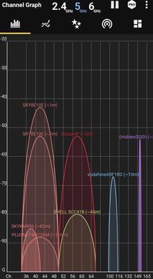

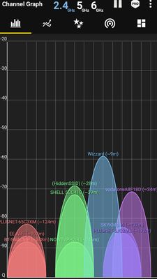

Message posted on 15 Dec 2023 04:52 AM
Re: Sky Q mini box disconnects then 15min it reconnects.
For 2.5 I use channel 9 see pic.
A pic of my 5g
Message posted on 15 Dec 2023 09:10 AM - last edited: 15 Dec 2023 09:23 AM
Sorry which ones are yours in that and those channels you mention (which aren't shown on the graphs) seem to be different from the channels up-thread unless I'm mixing up two different people.
Edit: ah yeah you were talking a out 2 5GHz channels earlier, not the 2.4 channel.
Just some minor pedantry - it's 2.4 not 2.5 and 5Ghz not 5G, that's a mobile signal standard. But I knew what you meant
Message posted on 20 Dec 2023 12:55 PM - last edited: 20 Dec 2023 01:15 PM
Sorry was just typos.
On the 5ghz sky is Sky8e10e my wifi is Wizzard.
