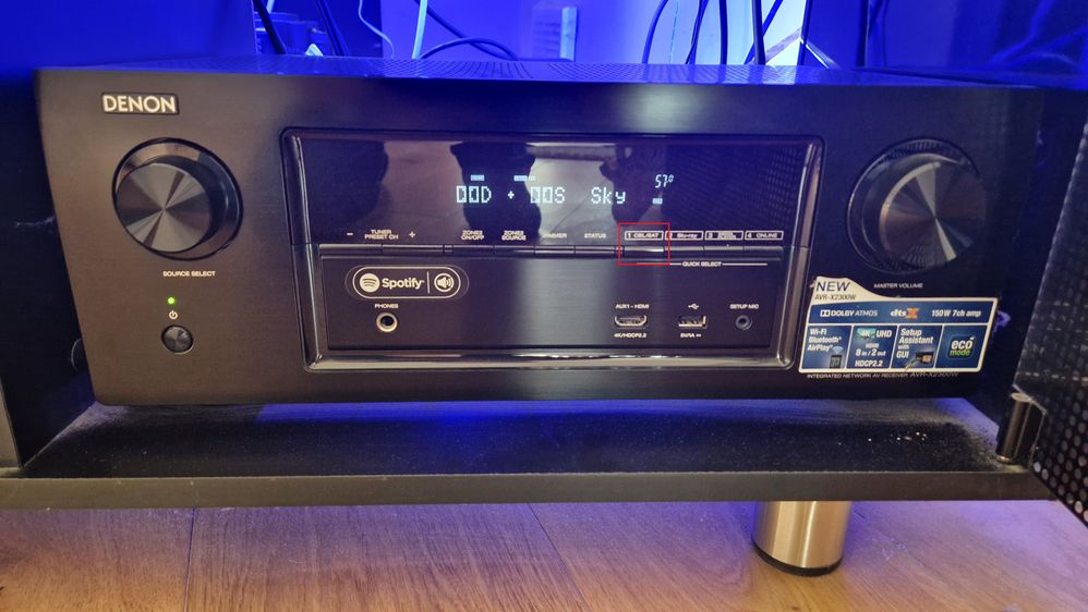

I have solved the issue. On my Denon receiver, I have a "Quick Select" setting for cable/sat. I pressed this and DD 5.1 audio started to output. It's a setting that you can register an a/v configuration so that a single press will set the settings to that configuration. I can never remeber ever setting this up, in fact, I know that I have never set this up, so I don't know why pressing this has corrected things. Anyway, it's back working. Thanks for the responses.
