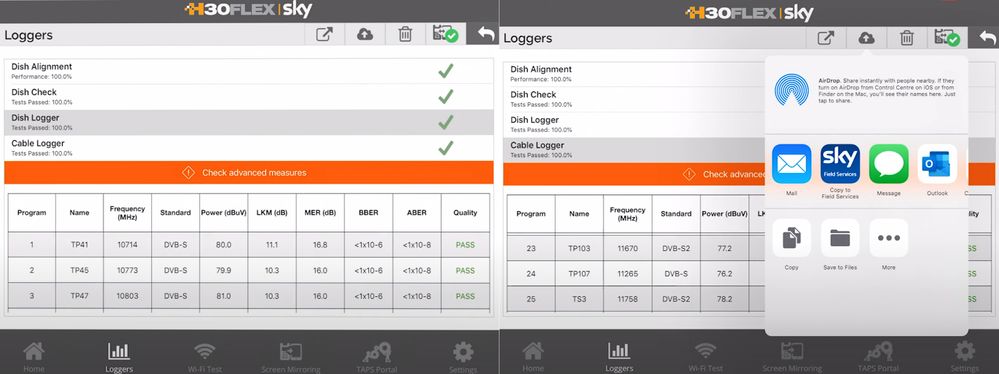

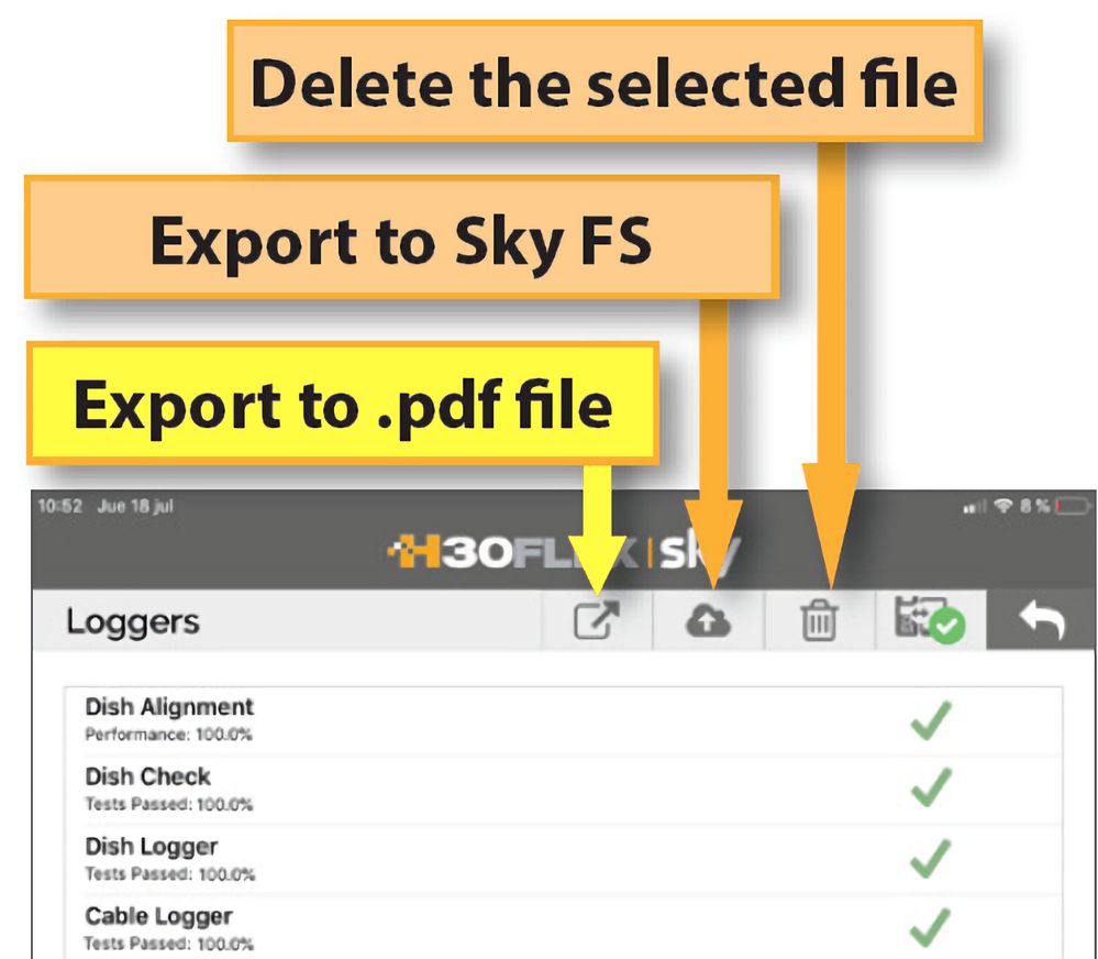

@Lucyliu2 Unfortunately your Sky engineer has clearly failed to follow the clear instruction issued to Sky Multiple Development Unit (MDU) trained engineers when their test meter discovers transponder signals that fail to meet the industry wide Confederation of Aerial Industries (CAI) standard for communal Integrated Reception System (IRS) installations, whereby they are instructed to export a copy of the test meter results to Sky Field Services, and then email a PDF file copy of the test meter 'logger' results to the customer.
If the loggers show fails there is nothing you can do to rectify the fault. Export the logger as a PDF and send to the customer via email so they can get the Managing Agent to make arrangements to have the block serviced.
The whole point of this instruction is to provide indisputable detailed evidence of the faults which have been discovered and require rectification by the communal maintenance engineer thereby removing any ability for this individual to impart their own particular personal opinions on what is adequate.
Your previous Sky engineer has fundamentally failed to follow this simple instruction, and in my personal opinion, Sky should not hesitate in sending another Sky MDU trained engineer who is prepared to follow the correct procedure when their test meter 'logger' reveals errors.

Thank you @Godfrey
Hopefully @Lucyliu2 can use your extract to persuade SKY to visit again to provide such a report & move this on
