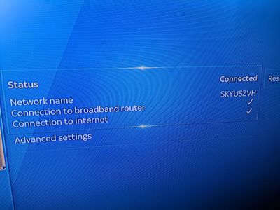

We have one multiroom box upstairs and one main sky Q box downstairs.
The multiroom box upstairs is connected and TV and recordings are all good.
However, there aren't any apps there so can't access Netflix or iPlayer.
On the main box there's an Apps menu item, but it doesn't appear on the multiroom box.
I've also seen that there's no access to MyQ in the menu. It gives the message "To enjoy this service we must have an active connection to the your internet".
There already is a connection to the internet as confirmed in the status and settings menus.
I'll include images to show what I'm seeing.
Can someone help please? It's so frustrating.

Ok... First check and the main box is on v Q220...
The mini is showing as Q060...
I guess that'll be the issue.
I've already performed software update on the mini.
How can I get this updated?

@oldfella I've updated the minibox 4 times now but the software version isn't changing from Q060.000.28.007 (4vayui8)
Surely if the updates are being implemented, the version number should change?
I just don't want to be here all day continually doing these updates if they're it working.
