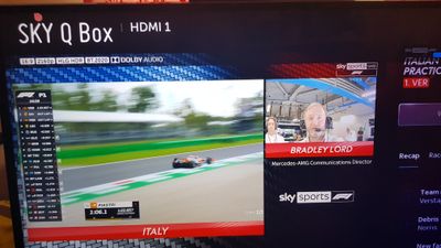

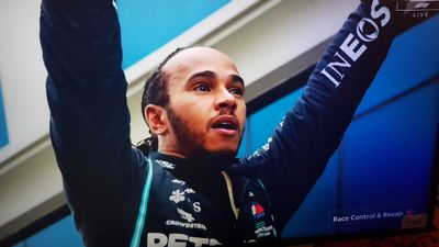

Fair comment @spacehopper  I may have found another workaround and still watching it Live without pressing the pause button for a few seconds
F1 has the red button for Race control and Recap
If I press the red button I see this menu
I'm wanting Italian Grand Prix Practice 1
If I select that I get another menu
And the option to watch in UHD if I select watch  in UHD I'm still within the red button service
So now it says Watching instead of watch in uhd
Just press the backup button twice to get rid of the side menu then press the up button for the side menu then the dismiss for full screen
So not getting the red button pop up as I'm watching the session via the red button I'll test it out with Luton v West Ham match tonight🤔

@best+of+the+best
Just tried it on the Crystal Palace v Wolves match and the annoying red button notification doesn't appear - presumably because I'm watching full-screen through the red button.
Happy now to watch the match at 4:30 without pausing.
