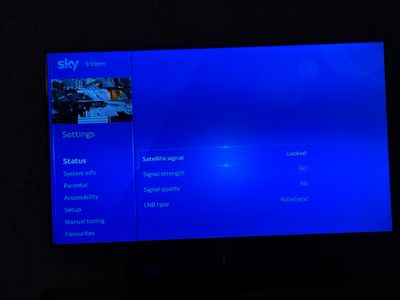

Whilst on ITV1 I went into the settings to look at the signal quality/strength:
Strength - 60
Quality - 90
LNB - Wideband.

BTW one thing to note that the Signal condition indicator can be misleading on SKY Q as it does not report the status of the channel you are actually watching but instead a transponder set in an engieers menu
