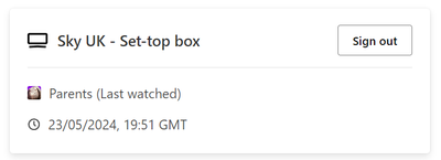

For clarity, click on your profile picture and then click on 'Account':-
Then click on 'Manage access and devices':-
Lastly, click on 'Sign out' for the device you want to remove:-
This will remove it immediately with no further dialogs. Clicking on the Netflix box from your Sky box should then automatically sign you in, although I had a message that it had a problem playing this title at the moment (Sweet Tooth S03E01 on the first advert). I logged out of Netflix on the box and then let it sign back in by itself which resolved the issue.
