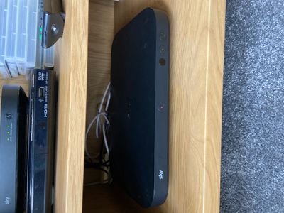

Discussion topic: My tv is saying No Signal, have switched everything off and on, all lights on still no signal
Message posted on 31 Oct 2023 01:32 PM

Thank you for replying and for advice. I think i'll need to get an engineer out. I've tried everything you suggested but still no joy?
thanks again
