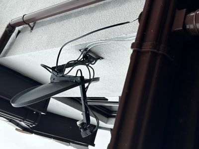

Message posted on 10 Jul 2024 12:42 PM
Re: Moving Sky Q main box upstairs
Message posted on 10 Jul 2024 12:52 PM
hi @Ailieme
It seems you do not have a Hybrid LNB but a standard Wideband LNB
Whilst we can see both sets of cable going to the dish, unfortunately, it is difficult for us to tell if the other room cables are long enough to change over - it may be possible but not easy to say
Message posted on 10 Jul 2024 12:53 PM
Hi @Ailieme Thanks for the photos. This tells us your upstairs cables do not connect to anything and you only have a wide band LNB. To move your box upstairs, you would need to pay Sky to move it.
