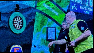

Hello.
I've just got a new LG Oled (B4) TV and I'm having periodic issues on the sky UHD channels - getting a weird 'oilslick' style picture (see pic). Sometimes it disappears then it comes back another time.
I've set the HDMI input on the TV to 4k (rather than off) and the sky UHD setting is 10 bit. Does anyone have any thoughts on resolving this??
Thanks in advance.
Message posted on 14 Jan 2025 03:06 PM
Thanks I solved the issue!
I just had to change out of the Ultra HD 8-bit setting and switch to a lower setting and then switch back where the offered me to chose Ultra HD 10-Bit.
A simple problem solved 🙂
Thanks for other comments of assistance.

@RDB6 wrote:
Hello.
Thanks in advance.
Hi @RDB6
Try a Reset Settings in the Q box hidden menu.
To enter hidden menu press Home and navigate down to Settings but do not select Settings.
With Settings highlighted press 0 0 1 Select.
Only Carry out the first Reset (Reset Settings) as the other two will wipe all recordings.
After the Reset you will have to re pair your Bluetooth remote If you use one.
If you cannot switch the Q box on with the remote after the Reset press the Standby button (Amber led) on the front of the box.
To re pair the remote press 1 & 3 together on the remote and follow onscreen instructions to re pair.
Make sure that you are pointing the remote at the Q box when you press 1 & 3 together.
Resetting the settings will also reset:
Audio visual settings, such as picture resolution and HDMI control
Settings changed within the hidden engineer menu, include LNB type. If on a communal dish you need to reset the LNB to SCR in the hidden menu. After changing the LNB type you need to reboot the Q box.

Worth trying 8bit too.

I'm having the same issue, just started today. I've tried a brand new cable also. Was working perfectly this morning and have not changed any settings. I also have an LG OLED TV
Message posted on 04 Jan 2025 05:42 PM
Re: Issue with Sky Q UHD picture
It works ok on 8 bit, but that's not HDR is it?

If 8bit 'works' then it points the finger at how the TV is processing HLG. (I'm assuming you have a HDR box)
Ensure the TV has the latest firmware (LG firmware changes quite frequently)

It was the darts and then on tonight's Brighton / Arsenal game. Often a little play on the settings or switching sky box off and back on fixes it. Until the next time! Bizarre!

Yes it was. Must be something to do with the HDMI handshaking between the Sky Q box and the LG TV. I don't think it's an LG issue. What is the hardware version of your box? I have a Sky Q 2TB box with version 32B107
I could "resolve" the issue by toggling to 8 bit and then back to 10 bit
Certainly am not impressed - may phone Sky next week. Let me know your box version

If it only happens on LG TVs (speculating since we have very little to go on) then it absolutely could be a specific issue with their HLG processing.
