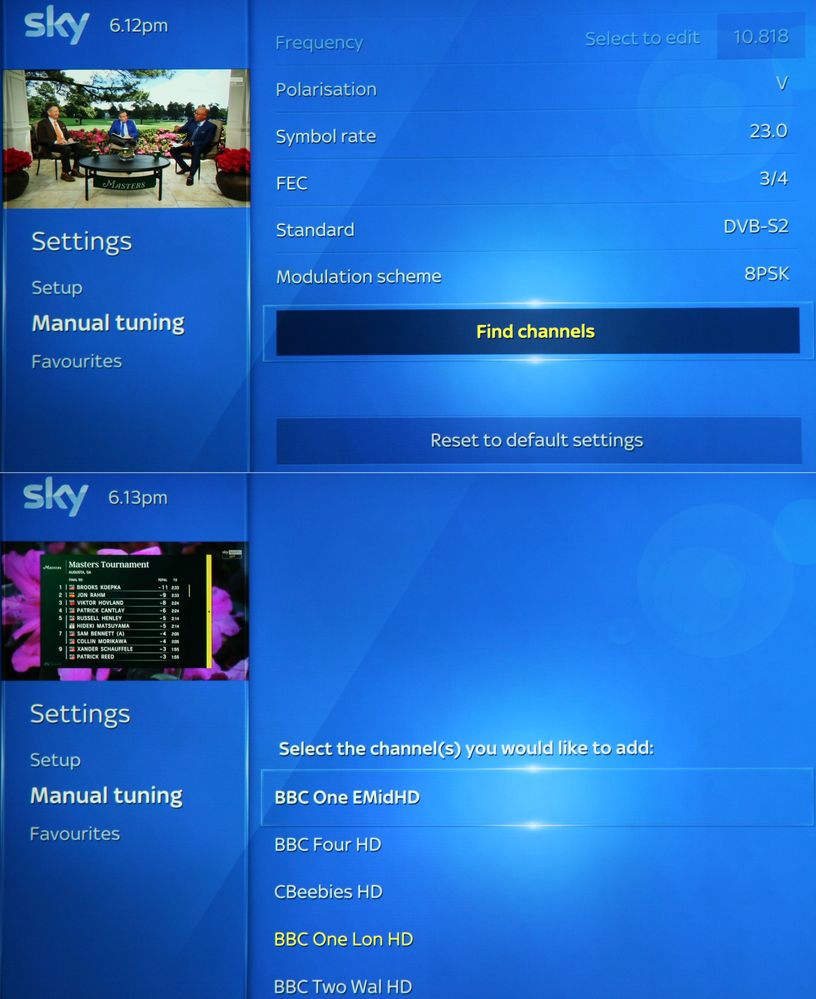

BBC London HD currently on:
Frequency : 10818
Polarisation :Vertical
Symbol Rate :23000
Modulation :8PSK
FEC rate: 3/4
Checked on my multisat dish/receiver
BTW my usual Reference which is usually very well kept up to date:
https://www.lyngsat.com/Astra-2E-2F-2G.html

hi @Pongo9723
Providing you set all the paramaters correct then it would perhaps point to your dish being very slightly out of alignment.
If you only want London then you may be limited - if you are willing to try other regions please use the link I gave to look for other regions on a couple of different transponders
