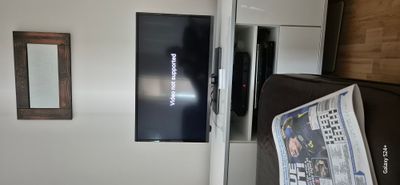

This discussion topic has been answered Discussion topic: Hi guys,problem i am having is the tv i have hooked up to Sky Q box will not fire up!

Try switching the Q box back to native 1080i video output.
On the Q remote press the following buttons:
HOME, 1, 0, 8, 0, HOME
See if that gives you any picture.

Message posted on 21 Jun 2024 10:57 AM
Re: Hi guys,problem i am having is the tv i have hooked up to Sky Q box will not fire up!
Thank you so much... i phoned Sky yesterday and the only advise they could give me was they would send Engineer on the 1st July.
You have sorted it for me by telling me this... thanks again, it really is appreciated. 👍
Message posted on 21 Jun 2024 11:00 AM - last edited: 21 Jun 2024 11:13 AM
That's apparently an older set which cannot support UHD (it's probably'HD Ready' or 'Full HD') : the advice @Padam_Padam provided changes the output of the Q box to HD.

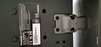

Message posted on 21 Jun 2024 11:20 AM
Strange you say that regards tv because its a Panasonic i bought which I'd assumed was modern.
Panasonic SMART Android HDR TV TX-32MS490B (2023) 32" LED Full HD Freeview Play.
But problem has been solved and thats the main thing.... thanks again
