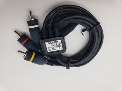

Perhaps worth noting a Mini box can also connect to a television set of that vintage using a Nokia CA-75U cable, which avoids potential HDCP issues at the cost of some image quality.

If there was any problem with HDCP on the HDMI inputs (which I personally doubt) then you would still be able to use it with a mini in SD mode using an optional AV cable (we can give details of such a cable to buy should you need one) to connect to the Analogue AV inputs
EDIT : I see @TimmyBGood has posted info for these cables whilst I was typing
