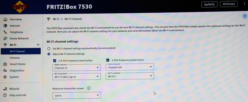

I have a new broadand router a Fritz.  Since getting the new router Sky q is slow when switched on and slow whien moving to a different channels etc and trying to fast forward and stop is delayed.  Has anyone had similar problems.  The broadband speed is good.

@Diane77  As an experiment, It might be worth configuring your Fritz router to stop automatically changing WiFi channels. Try manually setting your Fritz routers 2.4 GHz WiFi channel to 13, and the 5 GHz WiFi channel to 100.
To gain access to your new router type 192.168.178.1

It's possible the new router is clashing with Sky's own mesh - 5GHz channel 36 to 48 by default.

Thank you , this looks really helpful.
