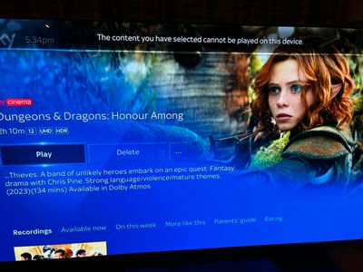

I downloaded the Super Mario Bros movie in HDR at Christmas and they've been watching it on the daily, but when we tried this morning we got an error saying "This content cannot be played on this device". I've downloaded the UHD version and that works. HDR is no longer an option, and
I've checked, and my display settings are set to 2160p 10 bit. I tried changing it to 1080p and back again, and even used the wizard to auto detect the settings and it put it on 2160p 10 bit. I don't have a mini box, so that's not the issue.
The settings on the TV are all correct. If I change the HDMI port it doesn't make a difference (the display settings are still correct) and if I plug my Xbox into the hdmi port the Sky box is usually plugged into it displays HDR content so I'm confident it's not the HDMI port or my TV that's the problem.
Any suggestions??

Hi @Laing1 if I go to 'All Formats' on Super Mario (or Dungeons & Dragons, or Across the Spider-verse) I no longer have the option to download in HDR. Ultra High Definition is the "best" format available. Also if I go to the Disney+ app via the Sky box, everything is just "HD" now, not 4k
or HDR10 etc.
