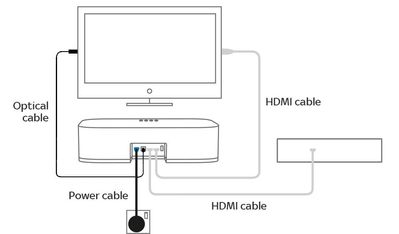

For some unfathomable reason, Sky and Devialet chose not to specify the Soundbox with ARC : that's almost certainly a decision which contributed significantly to it not being a successful product.
The anticipated way to get audio to the Soundbox from the television set or a device plugged into the TV is over an optical audio link, but not all televisions support audio pass-through.
https://www.sky.com/help/articles/setting-up-sky-soundbox

An alternative setup which isn't officially supported by Sky is to put an HDMI switch (not a splitter) on the Soundbox HDMI input and have both the Firestick and the Q box running into that: the switch needs to support 4K at 60Hz and HDCP2.2
