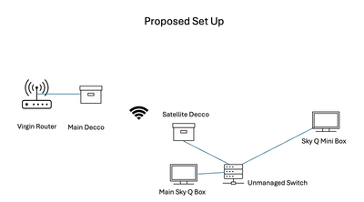

My Sky Q Main Box his hard wired to one of my Decco Satellite Units which runs on a wifi connection from the main Decco unit which is hardwired to my Virgin router. I have just had an extension put in and would like my Sky Q mini box to be hardwired as the distance between main box and mini box is causing issues.
As I understand it, the if I am not a Sky Internet customer, I am required to hardwire the Mini Box to the Main box as opposed to directly to the router. With this in mind I had a cable run to facilitate this but the Main Q box only has one ethernet port.
Question - Can I install a Switch/Splitter somehwere (At the Main Q Box?) that will enable me to hardwire both main box and mini box?

Yes, I have exactly that setup - minis via powerline ethernet into a switch which has the Q and a mesh node also attached.

thanks!
So my proposed topology is below. Can you please confirm that if I order an unmanaged switch (also reccommendations welcome) will the to be work?
