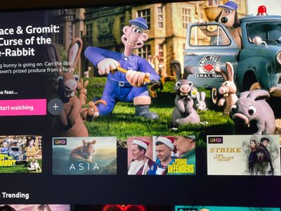

Message posted on 21 Dec 2024 04:21 PM
Re: BBC iPlayer UHD on SkyQ?
It can be a pain but search for ASIA that's avalible in UHD and shows it in the image
