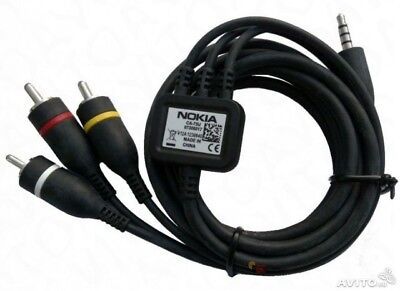

The cable known to work is the Nokia CA-75U, available on eBay for a few pounds.
Other apparently similar cables don't have the correct ring spacing on the mini-jack.

You could also try swapping your existing plugs over just in case they are wired accordingly.
I have a 3 way lead that doesn't work and one that does work but only by interchanging one of the audio & Video plugs over (i.e. the yellow provides one of the audio channels and one of the red or white - I can't remember which - provides video
As @TimmyBGood says we know the Nokia lead is wired suitably for the minis
