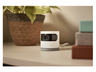

Indoor Camera
The Indoor Camera helps you keep an eye — and an ear — on your home, whether you’re in or out.
Where to place it
- On a shelf or wall with a clear view of the room
- Somewhere discreet that still covers key areas
Tips for the best setup
- Position it so you can see most of the room
- Make sure it’s:
- Connected to main power
- Within range of your Wi‑Fi and any sensors you’re using
If you use Auto arm, your camera will automatically switch on when you leave home.

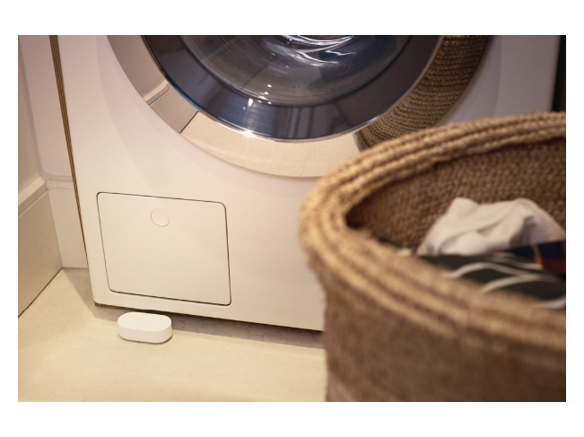

Leak Sensor
Leak Sensors help detect unwanted water — even leaks you can’t see.
Where to place them
- Place the sensor directly on the floor near water sources
Best locations include:
- Next to washing machines or dishwashers
- Behind kitchen kickboards near pipes or sinks
- Near bath panels
- Under boilers or hot water tanks
Good to know
Leak Sensors can also monitor temperature and humidity, giving you extra insight into your home environment.

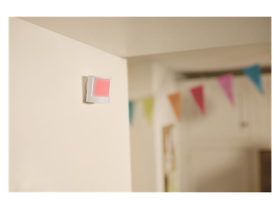

Motion Sensor
Motion Sensors detect movement when it shouldn’t be happening.
Where to place it
- Mount it around 1.8 metres high on a wall
Best locations
- Near main entrances or exits
- Close to windows or patio doors
- In garages or basements
