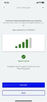

Step 1: Check your signal strength
A weak signal can cause your Smart Doorbell to use more power as it works harder to stay connected.
You can quickly check the signal strength in the Sky Smart Home app:
Here’s how to run a signal test:
  1. Open the Sky Smart Home App
  2. Go to Settings
  3. Under Device Settings, select Devices
  4. Tap Smart Doorbell
  5. Under Technical Information, select Signal
  6. Tap Run Test
For the best performance, aim for a Good signal (3 bars or more).
If the signal is weak, try:
  • Moving the Chime closer to the doorbell
  • Reducing obstacles between the doorbell and the Chime

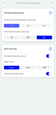

Step 2: Adjust your clip recording settings
If your signal is already good, tweaking your recording settings can have a big impact on battery life — especially if your doorbell faces a busy area.
To change clip length and time between recordings:
  2. Go to Settings
  3. Select Smart Doorbell Settings
  4. Go to Video Recording Settings
From here, you can adjust:
Clip Recording Length
  • 15 seconds – longest battery life
  • 30 seconds – standard setting
  • 60 seconds – shortest battery life
Time Between Clips
  • 60 seconds – longest battery life
  • 15 seconds – shortest battery life
Reducing the default 30‑second clip length can be especially helpful if your doorbell records frequent movement.
