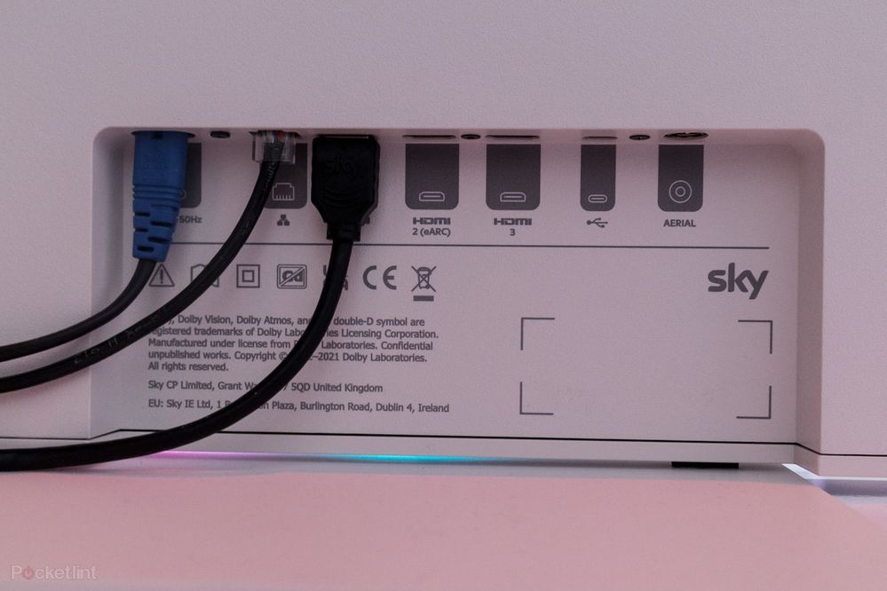

If your Glass TV is reasonably near your Sky broadband hub, they can be connected using a network cable aka an Ethernet cable. There should be four network/ethernet ports on the back of your Sky broadband hub and an identical single network/ethernet port on the back of your TV. Connecting a network/ethernet cable between the two will be a much reliable connection to the internet than using WiFi.
The network aka Ethernet port on the back of your Sky Glass TV is in between the power cable and the HDMI 1 port, as per @TimmyBGood picture in thread https://helpforum.sky.com/t5/Sky-Glass-Live/Accessing-the-ports-when-Sky-Glass-is-wall-mounted/td-p/...
