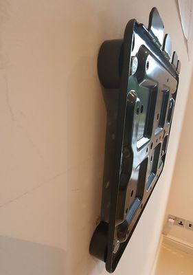

I have the first generation 43 inch sky glass TV. Does it come with built in wall mount and where can you find the parts to fix it to the wall? I can't find the internal spacers that it says you need. Where can I buy them from?

Yes: the wall plate design is the same and so all the spacers are 15mm thick.

If it's on the original furniture stand then that contains the wall plate as an integral component.  Sky doesn't supply fixings to secure the plate to a wall because those are the responsibility of the householder to get right, and will depend on the relevant construction method (expansion bolts for brick, load-spreading plugs for plasterboard, substantial screws for wood etc)

Thanks, yes I've got the original bracket but it's the black circle spaces that go from the wall to the bracket I'm having trouble getting or finding. I can buy screws it's those certain size spaces I'm looking for.

Sky Glass wall mount spacers are 15 mm thick, have a 35 mm diameter, and an 8 mm diameter bolt hole. The 15 mm thickness is the most critical dimension, ensuring the Sky Glass TV's lugs can properly seat on the wall mount's supporting lugs for a secure and safe installation. You can use generic M8 spacers or washers of the correct thickness as a substitute if you've lost the original ones.

I have the small TV the 43 inch are they the same size as the 55inch?
Re: Sky glass first gen 43inch wall mounting
@Skyglasstv25
