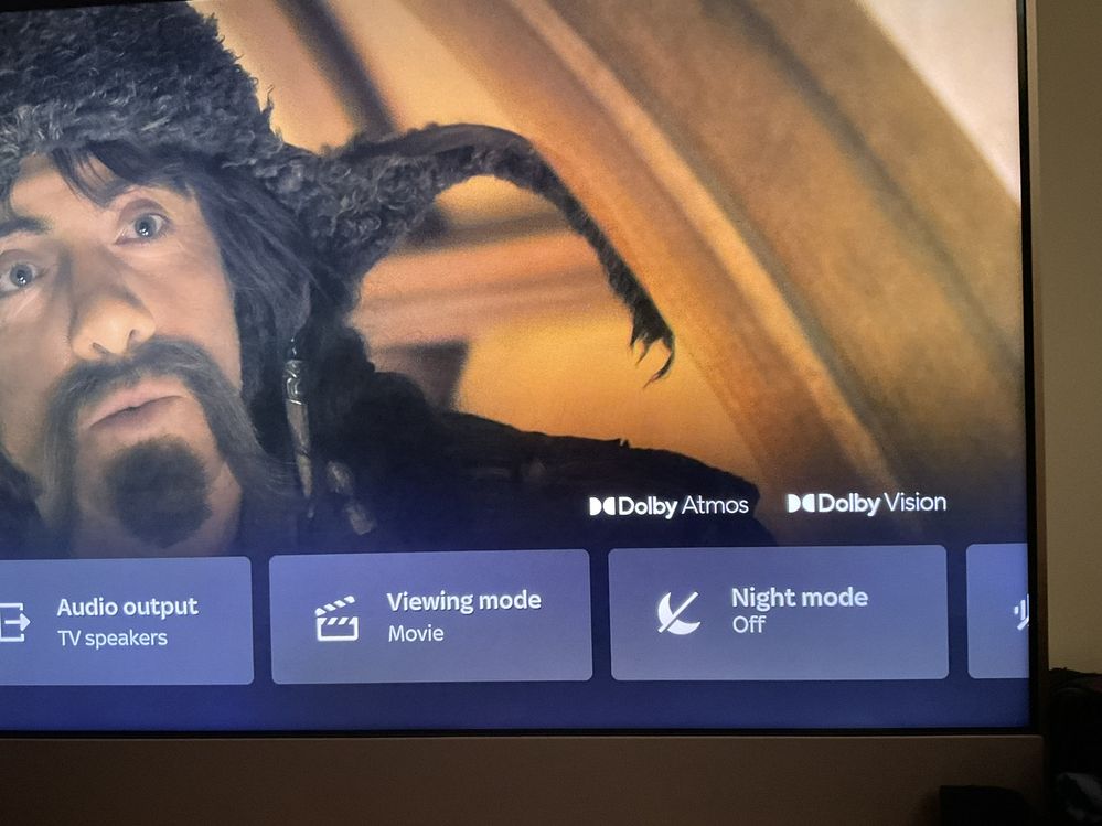

I have a 1st generation Apple TV 4K box hooked up to HDMI2 on our 43" Glass. It definitely plays back content in Atmos. Apple TV+ and iTunes content plays in Atmos fine, as does Disney+. Can't test Netflix & Prime Atmos content as I don't pay for their top tiers at the moment.
Following picture is The Hobbit 4k iTunes purchase playing from Apple TV 4K box with the ... button on the Sky remote to display the Dolby Atmos & Vision badges.
The Hobbit: An Unexpected Journey. 4k iTunes purchase via 1st gen Apple TV 4K

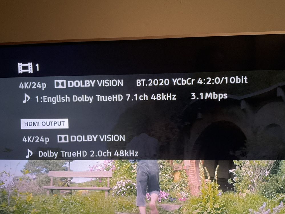

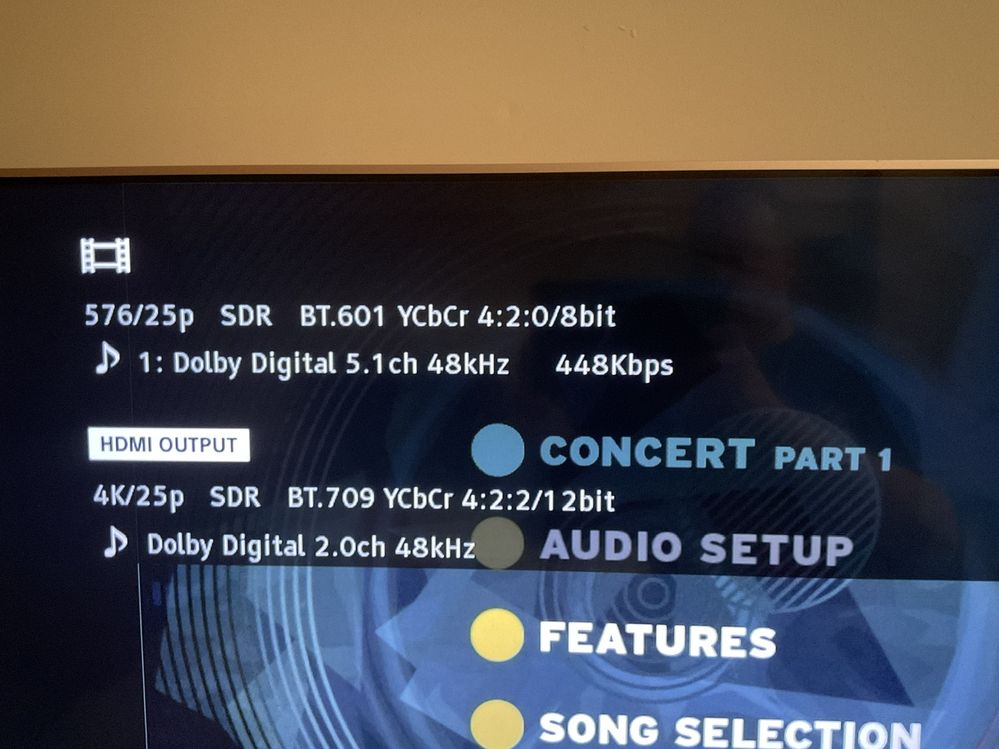

Message posted on 19 Aug 2024 09:10 PM
Re: How do I see the type of audio being played by an external device?
Addendum: Pkaying anything via my Sony X800 M2 4k BluRay player only played back as 2 channel stereo, whether Dolby Atmos/TrueHD from 4k & regular BluRay down to vanilla Dolby Digital on DVD.

Frustratingly, the Glass TV only shows the badges for Dolby Atmos & Dolby Vision, presumably a Dolby licensing requirement. Content in 7.1, 5.1 & HDR10 doesn't show any badge at all.
Not sure if there is an Apple TV box display overlay (developer mode maybe?) similar to the Sony disc player that shows the source audio config & channels and what is being delivered to the Glass TV via HDMI. I've assumed (but cannot prove) that if Apple TV can deliver Atmos via DD+ to Glass then it can also deliver 7.1 & 5.1.
