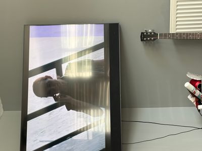

Hi I seem to have a problem with the picture on my Sky Glass TV. The picture is ok until you look at the right hand side of the screen and there is a dull stripe

Turn it off at the wall for 10 minutes then power it back on and see if it clears it.
This has been an on-going software glitch since Sky Glass launched. If the reboot doesn't clear it and you're still within warranty (2 years) then give Sky a ring for further troubleshooting and potential replacement of the TV.

@Mobee0902 I had exactly the same thing on my Sky Glass a couple of years ago. A normal reboot didn't help so I left ity inplugged overnight and when plugged it in again the line had disappeared and luckily never came back. Try this but if it doesn't work or the problem returns I would follow the advice given by @BenJoBanjo and call Sky to discuss a replacement assuming it is still within the 2 year warranty period.
