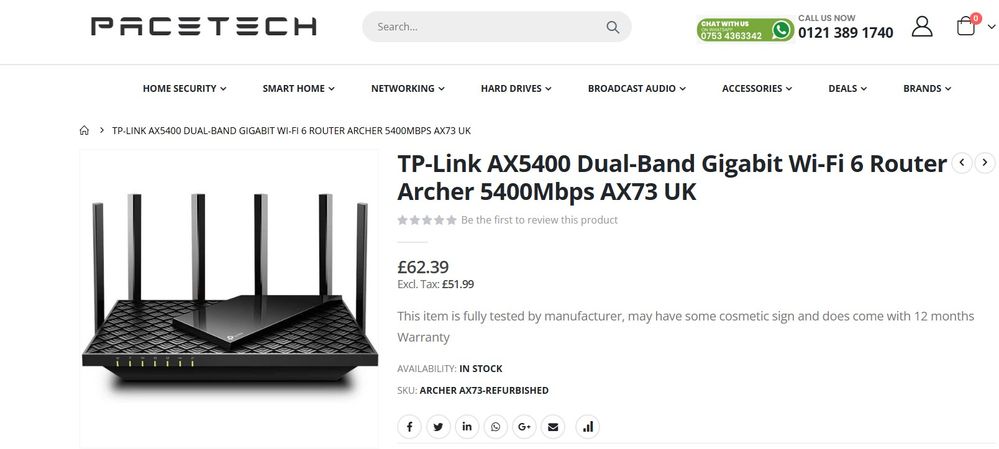

Those Wi-Fi extenders are not the best for Wi-Fi.
I appreciate not everone is prepared to spend a pile of cash on 3rd party router. I bought a refurbished TP-Link AX73 for £75 2 years ago and used it with Virgin Media..only recently sold it on ebay for £35.
But I never got full Wi-Fi all over the house. In my sons rear bedroom the PC would really struggle because it was behind his wardrobe...I got that sorted with a £20 powerline.
Yes you will get some improvement on Wi-Fi with a 3rd party router but it may not show 500Mbs in every corner. For example I have a 500Mbs connection. In my kitchen the Sky router was about 100Mbs....but with my own router now its 350Mbs but very stable.
Wi-Fi also depends on obstacle in the way such as solid brick walls and furnitures This was the router I used...not saying it will solve your problems but kept family happy for 2 years 😊
Important point...I kept the Sky router connected and connected the TP-Link to Sky router.
