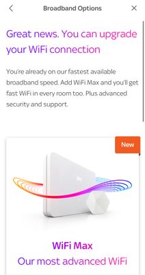

Hi I've read a lot on here about WiFi max not being compatible with a q mini and multiscreen setup as I currently have.
About a week ago a new broadband upgrade option appeared for me (in the added image) to add WiFi max. So I'm confused whether it would this is appearing my mistake or whether they are now compatible. All the latest posts on here say they won't work and I haven't been able to get a definite answer from any calls or live chat with agents. Obviously don't want to go for it if there's a chance it won't work having read other horror stories on here.
Thanks in advance!

@Jonnylatics1985 Sky have been working on overcoming the issue and last week Superusers were told customers with a main Q box and one mini can now order Wifi Max. The system is apparently imcompatable with more Q minis and the older boosters.

Thanks @Chrisee that's really interesting and super helpful! 🙂
