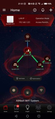

My network has split bands and each mesh node/ hub utilises wireless backhaul through my 3 storey home. The node furthest away recorded speed of 400/80 down/up tested using a laptop and ethernet cable (2F below)

3 x Asus XT9s + 2 x RT-AC58U V3 for WiFi (AP mode)
