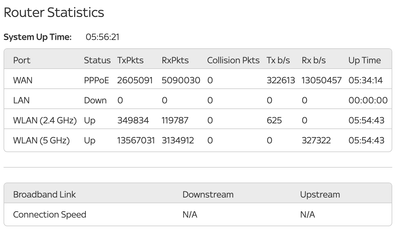

Thanks @Chrisee - these are the stats. I have to use my Mobile Broadband because Sky Broadband can't handle this much data.
Message posted on 14 Oct 2024 09:51 PM
Re: Very low upload speeds (0.01 Mbps) and many requests timeout
@NualaKK nothing apparently wrong with your connection as.the stats show data flowing normally on the WAN and the connection has been up for over 5 hours since the hub was last restarted. You are only using WiFi and the WiFi stats there look odd. Assuming you are using devices which are reasonably close to the hub could there be something causing interference? Failing that it could be a faulty hub.
