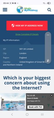

If you have got the sky message that you are live and with them they send a few bits off data out to the connected router and take over the connection, inform EE that's it we have the customer now and you are done, get the final bill finished and Bye -bye EE, You can sometimes see that router wise, as the IP and DNS change speed test etc may show, do the www.whatismyipaddress.com it will return something like below good sign they got you!
ISP: Sky Broadband
City: London
Region: England
Country: United Kingdom of Great Britain and Northern Ireland
Re: Using my own router instead of Sky supplied
  • @JimM1 looks like it is sky after all. No ipv6 but ipv4.

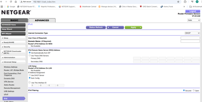

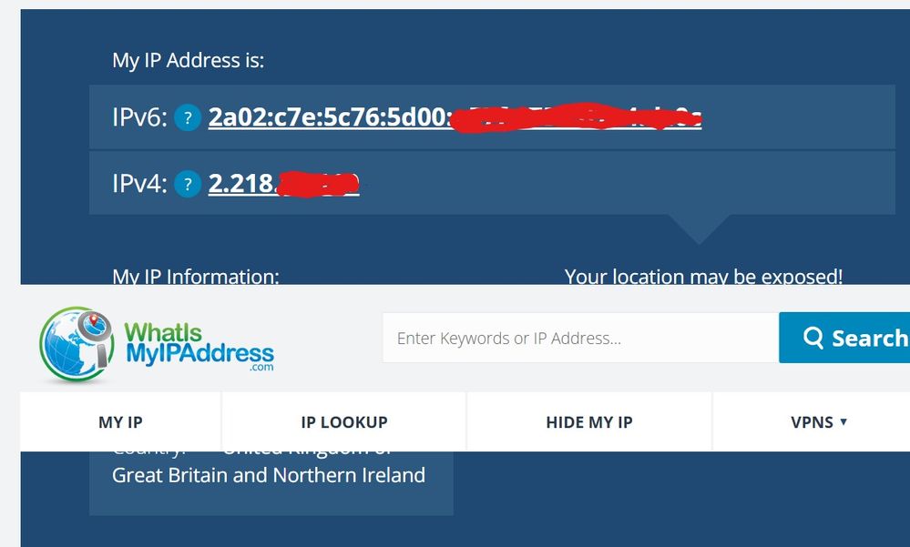

@MMMIIIUUUT IpV6 you may just need a tweak on your hub settings, not all get it out of the bat, had to make a slight adjustment on my Asus to pass through. Will look at the pic when cleared for viewing!👍 Pic is through now! Up earlier in the post you will see how the settings are but Asus, so no idea what needs adjusting on your Netgear but you will have to tweak it if not getting it through to your Router!
So you can see that it does work and no confusion!So you can see that it does work and no confusion!

I guess i do have ipv4 but for teh life of me and as expected cannot find anything to do with option 61, i set teh ipv6 connect to auto detect - nothing set it ti DCHP - looked for anything to do with option 61 - nothing.... Things are a sexpected so not overly happy.
@MMMIIIUUUT Had a quick look at my iPv6 settings, and if i remember correctly on my Asus connected to the EE network i had it set on Passthrough mode but when on sky i had to go set it to Native! See if you have anything similar for the Netgear settings, DHCPV6 PD is what you want and forget about trying to use or find the MER option61 it is not needed... You will see my settings earlier in the post!
