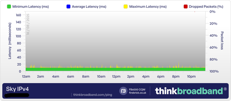

Message posted on 17 Aug 2025 06:31 PM - last edited: 17 Aug 2025 06:37 PM
Re: Using Deco X50 as primary router with Sky 500
@Sayek did you not say you also replaced the powerline as well, Tp-Link or another brand, wired, wireless/wired combined few options on powerline devices! And dropped packets are virtually non existent in all off you traces! So nothing is hanging up the hub in the slightest, normal operation looking real good!
