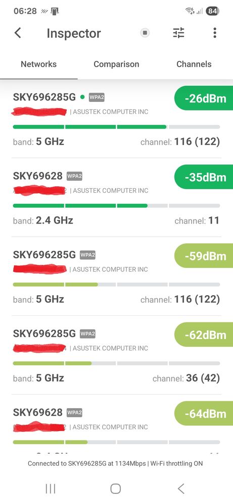

@Shazzy+Dee If you have an Android phone, then the app NetSpot on the google play store will show you what the Frequency and the Signal strength and also the Mac address that the phone is connected to at the camera location, it is a Free so do not purchase anything at all if you can use it! You can also plug in your BT disk and then compare what it shows at the same location point! Picture once cleared you should be able to see!
NetSpot picture of connected Routers/AP's
