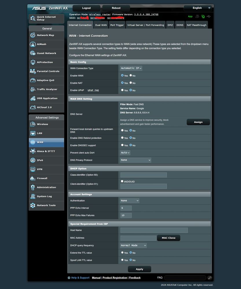

@gdunlop1981 Have PM'd you and the latest WAN screen capture is below once it get's cleared
Asus using google for the DNS Server

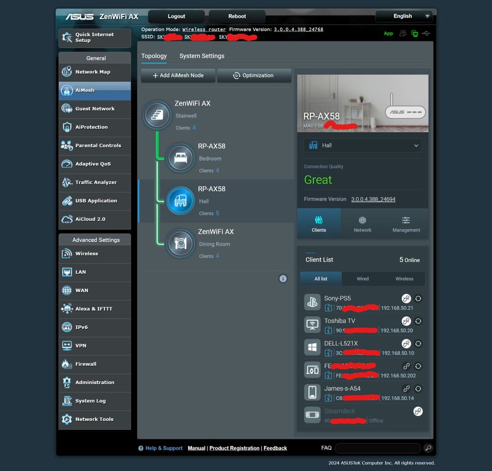

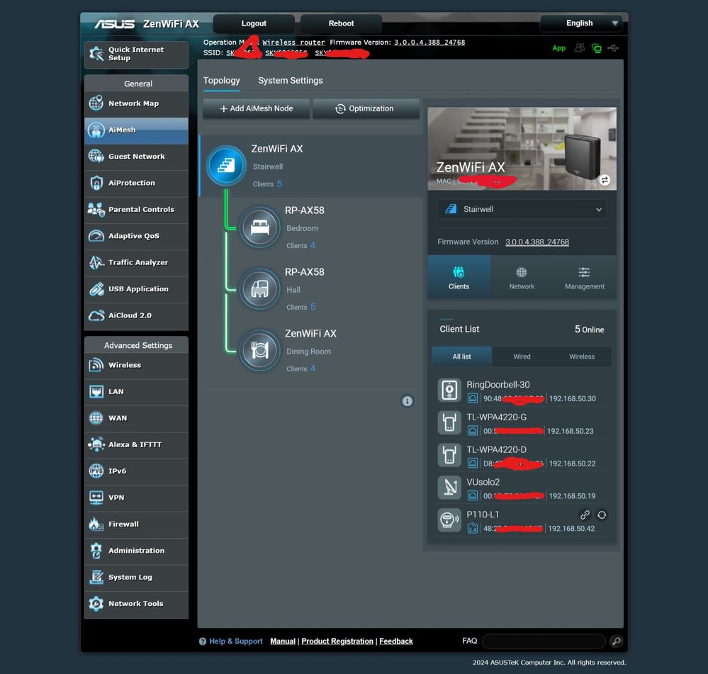

Edit:- added sample for AI Mesh on an Asus XT8 below.
Mesh picture 2 added on a wireless backhaul example below!
Asus AP Wireless Backhauled!

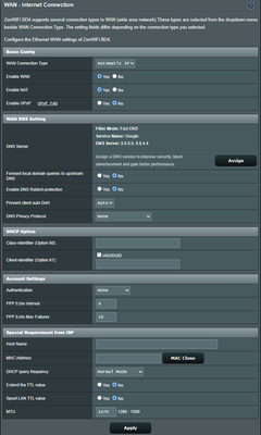

Hi Jim,
This is what I have now. It was asking me for an MTU so I used cmdprompt to ping google to find what my 0% loss was and added 28 as normal.
