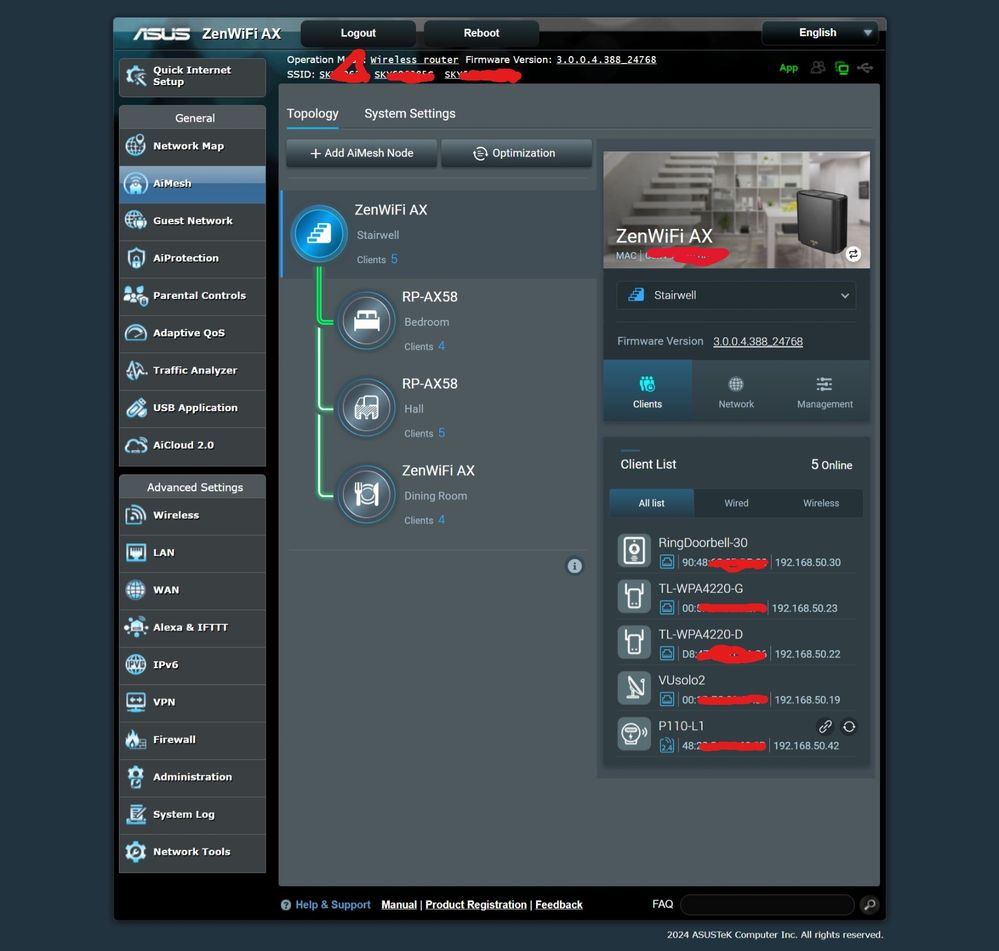

@splatto The WIRED AP that @Chrisee is explaining to you allows the remote AP device to be outside the sky wireless wifi extension range so that the signals do not interfere with each other, the same name just allows you to move between each with out having to go adjust your devices from one to the other as YOU roam between them that is all, devices that never move between either then you have seperate names it matters not what you do with the ssid names off both....
Seamless roaming you have the same name, devices may drop as they transition from one to the other but most do not! Mesh is entirely different and the advice is keep all the units from the same manufacturer so as NOT to cause issues between devices, so ie ALL Tp-Link, All Asus or All sky's own makes, gives less off a headache if done that way! Mesh is not easy too do, couple off pictures below for you but they are Asus based, and i have some Tp-Link in the mix wired/wireless control with devices black listed so as NOT to connect!

@splatto Agree, had an OP posted the other day, connected a Pod direct back to the Ethernet port off the sky Hub, and full speed delivered when testing wireless at the pod, there seems to be some dubiety about the pods if Ethernet Backhaul was working, so it's a who knows, never used sky max and never will! But the OP did seem to fully understand and from his post i could not disagree that he did not!
When my picture clears for you to see, the double line connection is a direct Ethernet Wired backhaul, and the single lines a wireless wifi backhauls, wired is way better but for sure the wireless backhaul on Asus works great, the units were all wired, wife did the furniture move so cables no longer reached, my bad so just flipped the units to Ai mesh wireless, not crawling under the floor boards again, as you know the furniture move will go back again it's a flip/flop i hope!

@JimM1 Your set up looks impressive, though a bit over my head at the moment.
