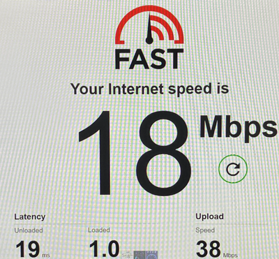

An engineer was sent last week, they installed another pod, set the positions etc. We were shown the speed in the far rooms as around 230mbps using fast.com, however running speed tests on all the consoles and devices in these rooms, most of them were not getting even 20mbps. 2 days later all the pods disconnected and never reconnected. Since this time, the wifi latency has been absolutely terrible in all parts of the house, even if connected directly to the hub or by ethernet connection.

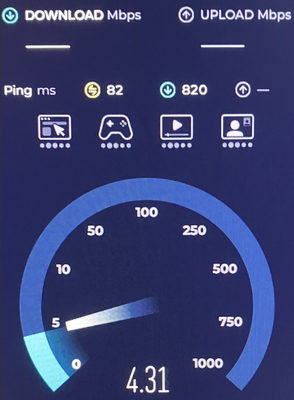

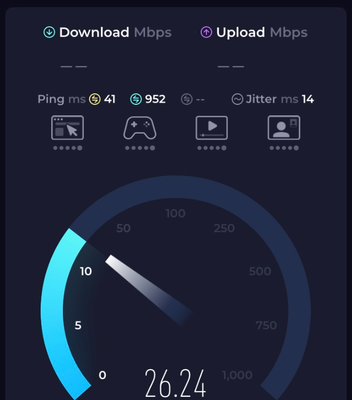

I have tried speedtest.net, cloudflare, fast.com, they all show terrible speeds. Most of them also show very bad latency up to 1000.
We had another engineer yesterday, the same was repeated and the results are still the same. The latency makes the wifi unusable and while the speed to the hub is fine, it definitely isn't to any of the devices. This has been trialled with ethernet connections to the pods as well and the outcome is the same.

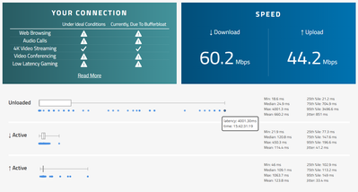

Re: Terrible latency and struggling pods/signal
Done a bufferbloat test.. the latency is just generally terrible and it just shows that I will have problems doing just about everything [which is true].
Don't know where to go from here..
