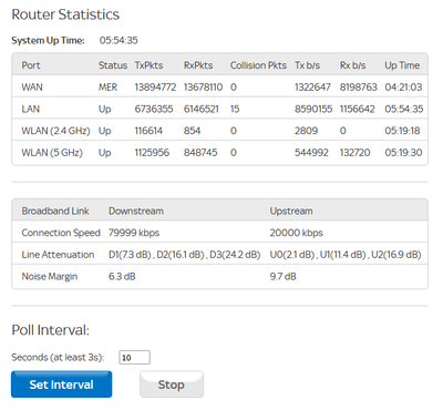

What colour sky hub do you have ?
If black could you post your router stats

Here you go:

That is 79 Mbps .the fastest speed on part fibre fttc

I would rely on the actual statistics at 79Mbps as that is the true line synch
Also the ethernet lan shows collision packets which are packets sent from router to device and returned again until tey are successfully received. Collisions can reduce the speed as seen by 3rd party test sites
Re the collision is the router directly connected to the computer or via an ethernet switch
