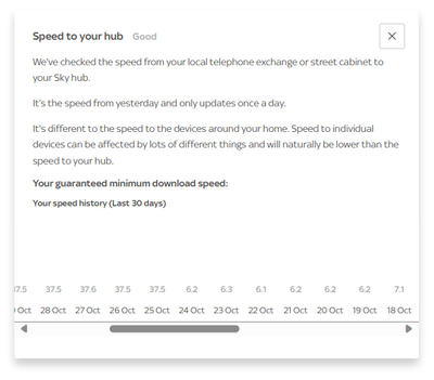

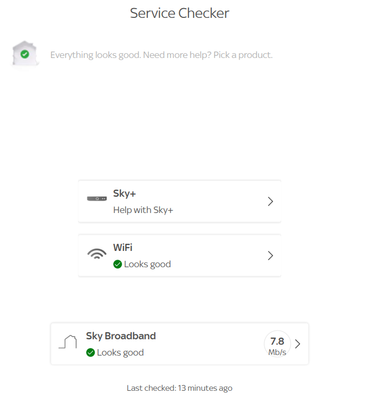

Message posted on 29 Dec 2023 04:36 PM
Re: Superfast Speed Lower than advertised
Check out the attachments below that i captured from the MySky account when
i was having issues, and sky advisor was saying everything was good, but it was in the toilet.
I eventually got like yourself visit's and had a sympathetic advisor who eventually listened
I lived with issue's for month's but now after pushing have got it sorted, but found that it is better
to be dumb, and not show any knowledge.
I used this just look 32Mb/s to 6Mb/s, the router and SKY thought your ok your on 40Mb/s
and it all looks good from our end, NO way THEY are correct.
Push and get it fixed.... Will take time..... For sure.....
