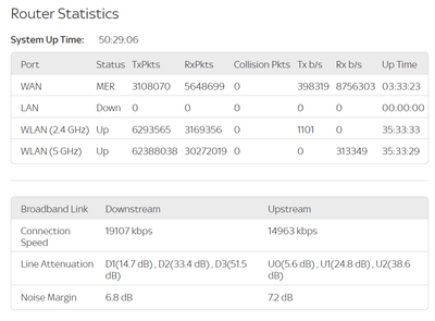

Yes of course, sorry. I was following the format of a previous post I saw. Hope this helps, thank you for the assistance.

There is a fault with the broadband line and it is below your minimum guaranteed speed (MGS), give Sky a call on 150 or run the diagnostics in the Sky App to book an engineer. The speed is showing just below 20Mbps downstream and 14Mbps upstream, the 20Mbps is below MGS.

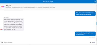

I spoke with a lovely representative last week (Tom) who ran a line test, found some stability issues but assured me there were no problems and that the broadband should improve day on day, returning to normal soon thereafter.
Unfortunately this has not been the case, the internet has been nigh unusable for the past 24 hours with constant signal drops and extremely slow download speeds.
Tom ended the chat stating I would be able to escalate my issue immediately should the internet not improve by the 12th of January but unfortunately it is actually worse than before.
I have included screen shots for your convenience.

Hi there @GuestWho I understand the speed has fluctuated, I can see the conversation with Tom, and that he discussed our Dynamic Line Management process (DLM). The speed will fluctuate during this 10 day process, and as advised on the chat, should the speed not be better around the 12th, then we can pick this back up.
At the moment whilst the DLM process is in place, we aren't able to impact the speeds just yet.

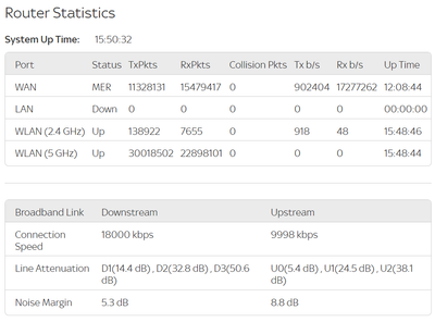

Hi @Lisa-P1987
I'm dissapointed to say I have to bump this topic again.
It is now the 15th and this internet has shown no signs of improvement, it is still below the gaurunteed minimum download speed and frankly is starting to become an issue for both browsing the web and taking video calls, which is ultimately going to affect my employment.
The internet has been bad for over a month, I'd expect a month reimbursed and if the issue cannot be solved I will be changing providers.
Speed below for your convenience.

The broadband line has a fault which won't get any better by itself or DLM, it needs an Openreach engineer to fix the fault on the broadband line itself.
