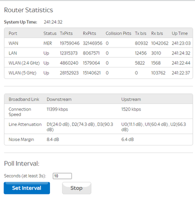

Re: Slow broadband but SKY say it's fine
Router stats as requested - it shows 11Mbps but it's 6Mbps at my laptop, but at the time of posting my original post it was about 0.8Mbps.
@JayBee5
It certainly is a bad line.

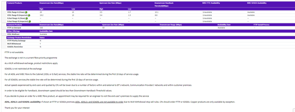

Could you enter your full address below and post the table after removing your address from the image
@cookiemonsteruk wrote:
@JayBee5
Although at least it's FTTC rather than ADSL: the outbound is too high for the latter.  Presumably a long distance to the local fibre cabinet.
broadband.pngHere is what you asked for:
@JayBee5
Theres a max of 20Mbps and a guarantee of 8-13 Mbps
So i don't know if sky will do anything.
Thanks for taking a look - if it is regularly out of the guarantee speed i.e. 8-13 (which it is) will they fix it? And how do I do that seeing as though the automates service keeps fobbing me off?
@JayBee5
Unfortunately the 'guarantee' isn't of a fix: it's increasingly common for the ISP just to offer early exit without penalty, particularly on tricky copper circuits.  You'll need to persist with logging a fault to get any attention.
