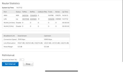

on a side note @mae-3  have you ever seen dlm get stuck on an upstream profile? mines been sitting  on 14993 with a snr 12.4,. I didn't think OR offered a 15Mb/s on up speed.
an eci cabb with a flakey card doesn't help my stats, but never seen or come across 15 profile uplink b4?

@TomThumb5ive
Usually the upstream noise margin above 6dB when below 20Mbps, especially as high as 12dB would indicate a fault on the broadband line or DSLAM cabinet card.

@mae-3  the cab card by all accounts is in less than perfect condition, but is still serviceable,
but to my benefit, it is way less sensitive to line conditions & dslam adjustment,
so given the detriment on the line caused by passing through several trees, it's probably the best compromise atm.
Downstream dose still bounce around with as expected behaviour, but having upstream seemingly capped at 15Mbs is something i didn't think OR was capable of doing.
Download sits between low 63 - 75 high Mb/s & anywhere in between,  but upload seemingly capped
@ 14993
