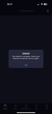

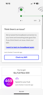

I have an almost daily occurrence of my broadband speed dropping and the resolution of my streaming video reducing significantly. The Sky broadband service checker is telling me that my connection speed is 469mb when none of my streaming services are loading and the Which? Broadband test as well as the app provided by Ookla demonstrate zero connection

I have only been with Sky several weeks but have noticed an almost daily intermittent drop in speed that typically resolves after a few minutes. Today my streaming video dropped to what looked like 240p for several minutes before cutting out completely for around 20-30mins. The Sky service checker reported no faults and speeds over 400mb which clearly wasn't the case so I attempted to check this with the other services mentioned.
I restarted the hub which appeared to correct the issue. But further testing with the other speed checkers mentioned (including fast.com) show speeds significantly lower than those provided by the Sky service checker. I'll maybe do comparison checks a few times a week to keep an eye on it.
