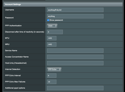

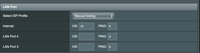

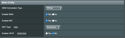

OK, after a bit of trial and error, I think I have something stable now
My config
WAN
LAN -> IPTV

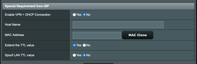

Sorry, one of the screenshots in the WAN didn't copy:

Thank you so much for the detailed reply. I double checked my settings against your screenshots and they were already identical EXCEPT for the "Extend the TTL" option. Once I switched this option to Yes the internet light on the box immediately went white and eveything is working again.
Lets hope that's the end of the issues now! Thanks again
