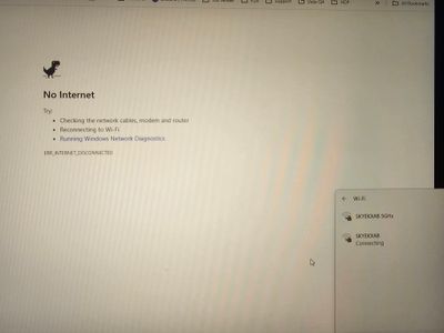

This message was authored by: Gl97
Re: Sky GigaFast WiFi - 2000 ping and >50 Mbps. Internet drops off
  • This is what happens after the signal drops. Can't connect to either network, have to restart router then it changes the channel I think.

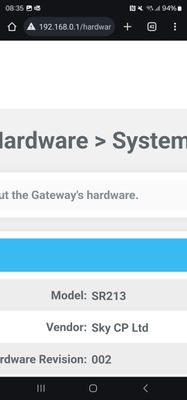

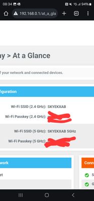

@Chrisee I appreciate your help, but I can assure you that I have the WiFi max hub and have both 2.4ghz and 5ghz networks split. I do see looking online that this is unusual and not normal. I will upload photos below. I'm unsure if this is some sort of bug related to just being connected yesterday - it let me change the channel etc yesterday morning, but now it does not.

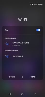

Avatar for Gl97
@Chrisee one more photo sorry - the two networks available separately. I split it initially because my partner's pc wasn't finding the network on her WiFi card so I split it to 2.4 and 5 which revealed it only found the 2.4 - I have since upgraded her WiFi card.

@Gl97 ss your hub was only installed yesterday might explain how you managed what Sky tell us is impossible and split the bands - did you use the web interface at 192.168.0.1 by any chance. Sky briefed us that the hubs need 24 hours to uodate and optimise I can only oresume you got in before the normal firmware loaed diszbling the ability to make changes using the web interface. Instead all changes have to be done using the My Sky app.
I suspect a factory reset is the only way to get yhe hub back to "normal" to do thst pess and hold in the WPS button on the side for at least 15 seconds or to when the led blinks.
@Chrisee yes I did use the 192.168.0.1 interface. Sounds like I did indeed change it just before the proper firmware loaded. It sounds like it's advantageous for me to reset it so I'll give that a try, thanks for your insights!
