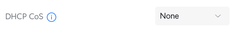

In a recent Unifi update they introduced a new option for "DHCP CoS" and I'm wondering if that would help at all?
My current (working config) looks like this (although I only get an IPv4 WAN address and no IPv6)
