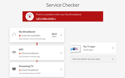

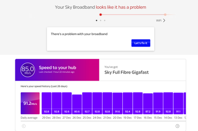

@ravshi Do you actually have the whole 12 months captured at those speed's, that is the question? You can see on the service checker what is going on with the speed from sky to your hub! See a sample below but on the FF500 connection that i have before i changed the sky hub out!

I had always thought Sky will keep a record, if not, great tip, I'll screen shot.
See below as well, that's all i ever see:
What's the next step?

@ravshi Your posted pictures require to be checked before released for general viewing, so will look at them once cleared.
You really have to do a wired Ethernet connected device to the sky Hub and speed test that way, so have you ever done that in the meantime while waiting?
Your picture is cleared, so for me i would be changing out the cable port 4 wan connection on the sky hub to the ONT Fibre modem!
One bad connection you are limited to the 100Mb/s speed range!
