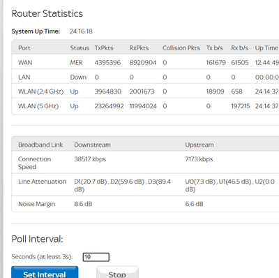

@KevinK3 Please can you post your router stats so the forum can advise on any issues. This link explains how to do that https://helpforum.sky.com/t5/Broadband/How-to-find-your-Sky-Broadband-router-stats/td-p/2855717#
Message posted on 16 Jun 2024 11:09 AM
Re: Sky Broadband router not reliable
Router Stats

Sounds like a wiring or interference issue if people going into the bathroom cause a loss of connection. Hopefully you are not actually on ADSL but rather VDSL (ie Sky Superast) which uses high frequdncy carrier signals. Does your phone wiring go near the bathroom or is there a fluorescent liight which could cause the connection to drop?
There are literallly millions of Sky hubs in use and while they are not the best routers you can buy (Sky dont charge for them after all) they are in general reliable. If multiple examples have the same issue it is almost certainly something environmental.
Edit I now see your stats the line last dropped 12 hours before you took the stats and the hub last started 24 hours ago. Your line is not running particularly well as the noise margin is somewhat raised at over 8dB which is consistent with the drops you report if they are definitely linked to the use of the bathroom that implies an issue in your home. However recently there have been a number of reports of lines dropping due to the exceptionally wet weather so it could be thst. There is nothing to indicate a hub fault.
