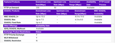

Thanks, that's quite a lot of information I don't understand.
I guess this is the important part?
> ADSL, ADSL2+ and SOADSL availability: If shown at FTTP or SOGEA premises,ADSL, ADSL2+ and SOADSL are not available to order due to WLR Withdrawal stop sell rules. CPs should order FTTP or SOGEA. Copper products are only available by exception.

@Adslhunter The rules link also below. will see the posted picture when cleared for viewing, and you have blanked out any personal reference on it like address and street cabinet etc....
https://www.openreach.co.uk/cpportal/products/the-all-ip-programme/stopsell-updates/

There is nothing identifiable in the screenshot. I have cropped out the name of the exchange. I'm still really none the wiser. My flat has an Openreach Master Socket 5C installed, which I guess is due to become obsolete?

@Adslhunter You had a VDSL line possibly with a OR 5c master socket and the speeds would be 80/20 or 40/10 split, as a new customer and if it is now withdrawn then sky Will not be able to sell anything to you until Full Fibre becomes available, it is also the same if the waiting list for VDSL becomes available people jump all over that and now nothing for you, some wait years to get it as not everyone can! Your picture will say once it can be looked at!

@Adslhunter  Image approved.
