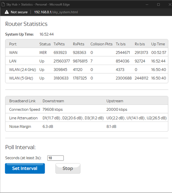

Message posted on 20 Dec 2024 01:41 PM
Re: Sky Broadband drops multiple times a day
And here are the router stats
